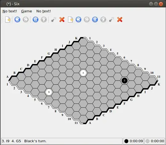

And then launch game with LD_LIBRARY_PATH=/usr/lib64 six to get
six on Ubuntu MATE 20.04 LTS
Note: currently I do not know how to fix "No text!" labels, but game seems to be working.
