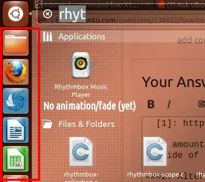

3. Alternative B: Use a custom shortcut to launch the Dash by clicking on the Ubuntu Logo, thus bypassing the animation
We can exploit the fact that the opacity/fade animation does not happen when you launch the Dash via the "start" button, or, if your cursor is on/around the launcher bar, even if you press Super:
The animation will be delayed until your cursor actually moves inside the dash area.

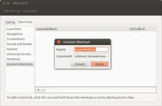

- xdotool allows automation of keyboard and mouse clicks/movements; install it with
sudo apt-get install xdotool Open Settings...Keyboard, and go to the Shortcuts tab. Create a custom shortcut, naming it whatever you want, and set the "Command" to:
xdotool mousemove --sync 25 60 click 1 --delay 100 mousemove restore
- You may need to adjust the coordinates (25 60) a little if your screen resolution is below 1024x768 or so.
Click Apply. The right-column will say "Disable", click on it and you'll see "New Accelerator": press your shortcut key combo. You cannot choose Super, even if you disable it in Compiz, because it is hard-captured by Unity. I chose
Ctrl+Alt+Zsince it's close to the Super key.Now your shortcut should launch the Dash much, much faster.

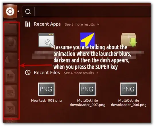

- Here's a Youtube video demo. The first few times (when the launcher on the left blurs and darkens) is with the SUPER key; then its with the custom xdotool shortcut (notice the launcher no longer animates and the dash appears faster)
