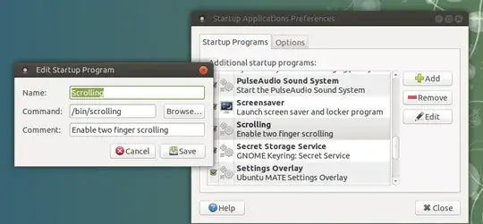

In the MATE desktop environment you can autostart programs after login or restore previously opened in the MATE Control Center.
  • Add "autostart" programs using the "Startup programs" tab. You can specify both graphical and command line applications (image source). You can simply specify the name of the executable if it is in your search PATH, else specify the full path name.

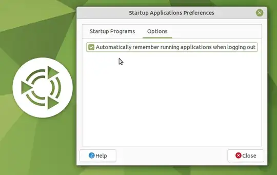

  • Use the tab "Options" to enable saving your session:
    MATE Startup Applications
    and check Automatically remember running applications when logging out here.
