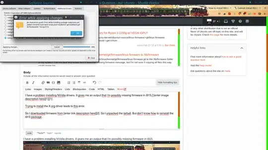

I have a problem installing NVidia drivers. It gives me an output that i'm possibly missing firmware in i915.enter image description here . And when I try it through software sources it gives me pk-client-error-quark: error while installing package: subproces from package intramfs-tools script post-intallation returned errorvalue 1 (313).enter image description here
So I downloaded firmware from enter link description here. And I unpacked the tarball. But don't know how to reinstall the i915 package. Please tell me how to install this.
It also won't fully install the Xorg driver ( same errorvalue 1 (313)).
I think I need to reinstall the i915 package in order to install the nvidia drivers correctly. But I'm not sure.
Does anybody have a solution for me how to solve this.

update-initramfs: failed for /boot/initrd.img-5.11.0-41-generic with 1.
dpkg: fout bij verwerken van pakket linux-firmware (--configure):
subproces van pakket linux-firmware werd script post-installation geïnstalleerd gaf de foutwaarde 1 terug
Instellen van linux-image-5.11.0-41-generic (5.11.0-41.45~20.04.1) ...
Instellen van initramfs-tools-bin (0.136ubuntu6.6) ...
Bezig met afhandelen van triggers voor initramfs-tools (0.136ubuntu6.6) ...
update-initramfs: Generating /boot/initrd.img-5.11.0-41-generic
E: /usr/share/initramfs-tools/hooks/plymouth failed with return 1.
dpkg: fout bij verwerken van pakket initramfs-tools (--configure):
subproces van pakket initramfs-tools werd script post-installation geïnstalleerd gaf de foutwaarde 1 terug
Bezig met afhandelen van triggers voor linux-image-5.11.0-41-generic (5.11.0-41.45~20.04.1) ...
/etc/kernel/postinst.d/dkms:
  • dkms: running auto installation service for kernel 5.11.0-41-generic
    ...done.
    /etc/kernel/postinst.d/initramfs-tools:
    run-parts: /etc/kernel/postinst.d/initramfs-tools exited with return code 1
    dpkg: fout bij verwerken van pakket linux-image-5.11.0-41-generic (--configure):
    subproces van pakket linux-image-5.11.0-41-generic werd script post-installation geïnstalleerd gaf de foutwaarde 1 terug
    Fouten gevonden tijdens verwerken van:
    linux-firmware
    initramfs-tools
    E: Sub-process /usr/bin/dpkg returned an error code (1)
So it still gives me the error code (1)
