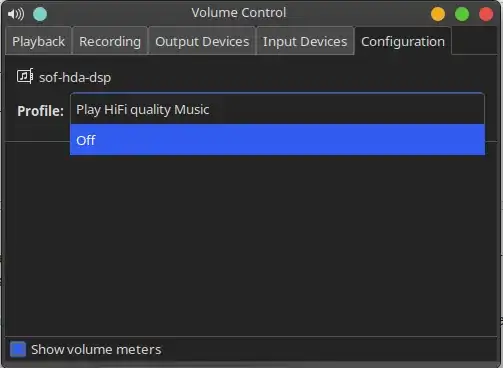

Weirdly there are no proper Profiles either: pavucontrol

Edit (3): I uploaded my system information on Alsa: http://alsa-project.org/db/?f=bef1ab7988c496cd50cce59779ad3135a5fa0079
Edit (4): I have tried it with bluetooth dongles instead of the internal bluetooth. No success either. This makes me believe it's a software-related error. I have installed the newest bluez-version from the sources. I'm not able to compile blueman, so I used the one from apt.
