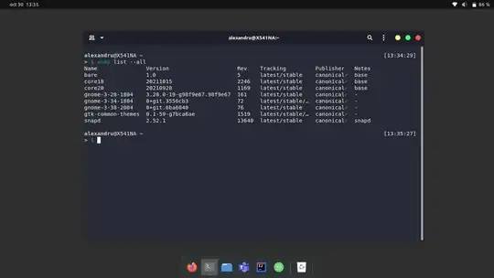

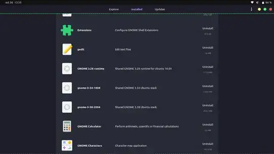

I'm using Ubuntu 21.10 with Gnome 40 and i found in Ubuntu Software three different version of Gnome.
T
I wanted to see if they are disabled to uninstall them but don't show if their disabled or enabled.(snap list --all to see if them are disabled or not)
Snap command in Terminal
Should I uninstall them?It is safe?

Those are the GNOME backends for the snap apps, which use those versions of GNOME as their dependency. In case you are using snap apps, don't remove them.
In case you don't plan to use snaps, then you can remove snaps altogether (which will remove those shared GNOME versions as well) and further, prevent it from automatically getting installed again.
Removing a GNOME backend by force, without uninstalling all the snaps which depend on it would be a bad idea.
