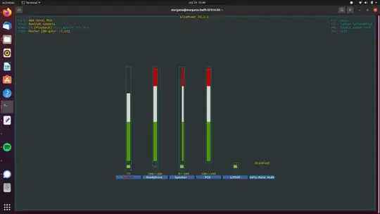

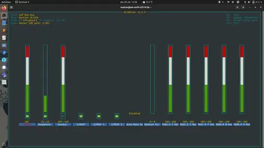

Further, ON THE WORKING DEVICE, alsamixer looks like this, while on the NOT-WORKING device it is this one
So, now the question: does anyone of you know what the problem is and how to solve it? How can I make the not-working device having the same settings of the working one? I see that they different sound card settings and firmware.
