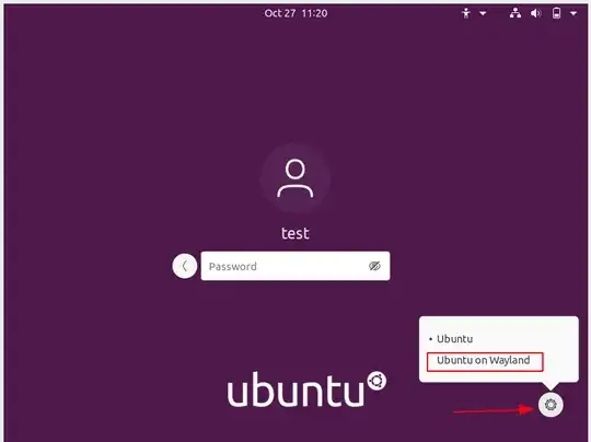

I went through the fresh installation process on my device. I installed ubuntu on HDD and SDD. Logging into HDD took 2 minutes after entering the password. There was a black screen for more than 1 minute. There is a gear icon at the bottom right-click on it and select the 'ubuntu on Wayland' option on that. It might work for you. enter image description here SSD took 10-15 seconds and the device was ready to use.
