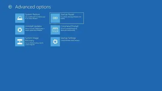

I initially installed Dual Boot with GRUB with Ubuntu 20.4.3 LTS and Windows 10 on 2 different partitions. About 4 months ago my Windows 10 automatically updated to Windows 11. It ran fine most of the time. But 2 times I received the "Inaccessible boot drive" error when I tried to start Windows. The first time, I went to Windows's Startup Repair and it worked. enter image description here
After 1 month of working fine, this morning booting into Windows 11 again shows the "Inaccessible boot drive" error. I tried Startup Repair and that did not work.
