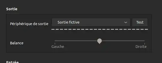

I just bought a NUC10i5FNH and installed Ubuntu 21.10 and i don't have sounds. In parameters i can see this ("Sortie fictive" == "Dummy sound"):
screenshot of dummy sound
Note this computer have a HDMI output only.
Sometime (rarely) sound works, and in place of "Dummy sound", i can see HDMI sound output (something like this).

Surprisingly, after running the program pavucontrol, HDMI sound card is permanently seen. Sound works fine now.
