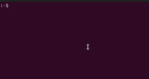

I recently updated from Ubuntu 21.04 to 21.10 and the upgrade has changed the behaviour of my Ctrl+. key combo. It didn't used to do anything, which allowed application specific shortcuts, such as VSCode to open the 'Quick Fix' menu.
Now it is hijacked by the OS and inputs a weird underlined e character in all text inputs. It does not show in any shortcuts in accessibility or keyboard settings, I have tried to disable the compose key, disabled the Alternate characters key, changed keyboard input source and nothing works.
Weirdly, the e and following words follow to all windows and I can't type a space either. I need to know what this is so I can turn it off and use my VSCode hotkeys properly again. Hitting ctrl+. again or escape reverts it.

This is shortcut for entering emoji. For example press ctrl+dot j o y space enter. To change it, run ibus-setup
It's the Emoji annotation shortcut and you can change it using the IBus Preferences dialog (ibus-setup).
This is how it's supposed to work:
When you press the Emoji annotation shortcut key (e.g. Ctrl+.), the "e̲" character that's inserted into the text signals that you have switched from the regular mode to the emoji annotation mode. Press it again or Esc to switch back to the regular mode and the "e̲" character disappears.
