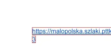

But recently I noticed that I am unable to print files with links in them
I have a big pdf file that could be send to printer with no reaction at all and disappearing from printing queue. Deleting this link caused to get a printable file.
This seems weirdly specific and hope that maybe someone has an idea what is going on.
Extra info as requested:
  • I am using Ubuntu 20.04 (Lubuntu to be extra specific)
  • I tried making simplest possible PDF with just link and it printed fine. So either original file was extra-special or it fixed itself in some update. I will try tracking it down.

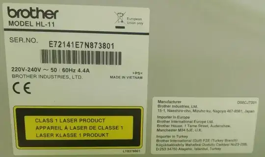

  • printer model:

  6. What is the exact model of your printer? There seems to be no HL-11.
