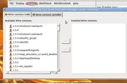

Install playonlinux there you will have this option. It is a frontend to wine, and makes it far better.enter image description here
This picture was taken on a 12.04 - 64bit system.
