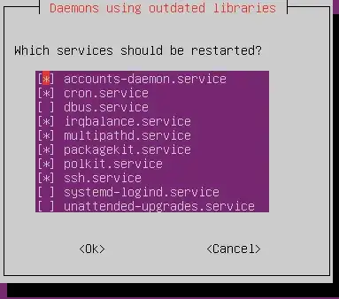

I have an unattended script for installing servers. At the beginning of the script there is a sudo apt-get dist-upgrade --yes. The dist upgrade has a nasty user input screen at its end asking to restart services:
Is it possible to autoaccept service restarts or disable this screen? It breaks my whole script. Also Im afraid it might leave my server stuck at some point when updating...
same result with apt-get upgrade
edit: I tried without success:

Other answers just skipped needrestart altogether.
But the environment variable NEEDRESTART_MODE allows to specify a mode. And by choosing "(a)utomatically", you can benefit from needrestart without being blocked by the prompt:
sudo NEEDRESTART_MODE=a apt-get dist-upgrade --yes

As others mentioned, the trouble in this case is with the needrestart command, which is part of the apt-get upgrade process in Ubuntu now (specifically 22.04 which is what I am using). By default this is set to "interactive" mode which causes the interruption of scripts.
To change this behavior, we can edit the /etc/needrestart/needrestart.conf file, changing the line:
#$nrconf{restart} = 'i';
to
$nrconf{restart} = 'a'; (if we want to restart the services automatically) or $nrconf{restart} = 'l'; to simply list the services that need restart.
