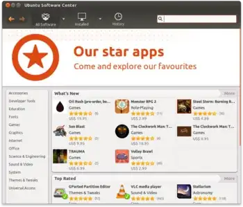

The software center is a tool which allows you to view all software packages held in the ubuntu repository in a graphical user interface. It's the utility which looks like this:
software center
