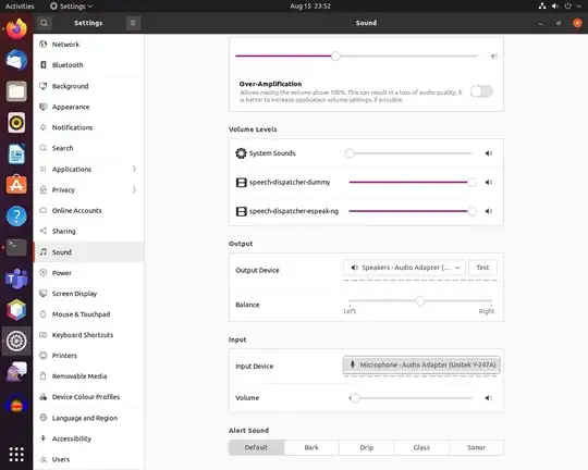

However, after disabling the internal speaker through pactl unload-module 23 the microsoft teams app is giving a message that it was unable to detect a microphone.
The USB microphone from the headset is listed:
mic
Having "removed" the internal speaker, sound was directed correctly to the headset -- but the mic isn't registering.
Prior to disabling the internal speaker, other voip apps were working fine. Now, along with microsoft teams, the textnow website doesn't seem to find a microphone.
The headset works fine on a different box, which is also running 21.04 but which lacks an internal speaker capable of playing music or other sounds through, I think, HDMI as the first box.
