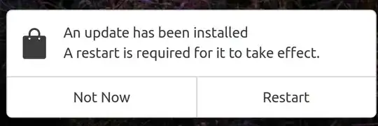

Update
The problem persists but when I click "update" a message box appears saying an update has been installed and a restart is required:
... and then a few seconds later an error message shows up showing a failure in downloading repository information (the internet connection is fine):
