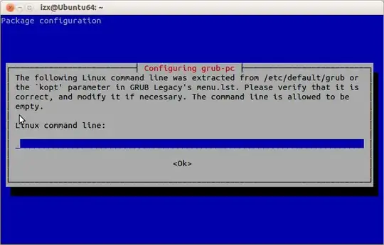

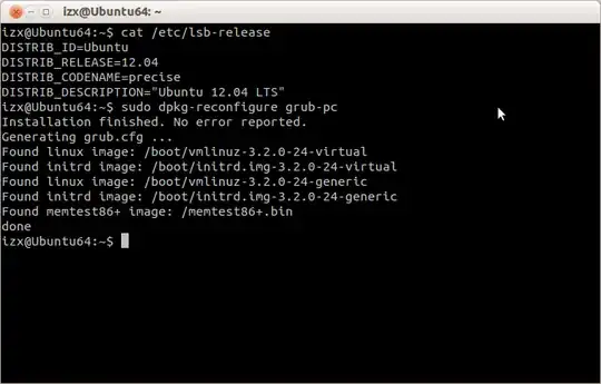

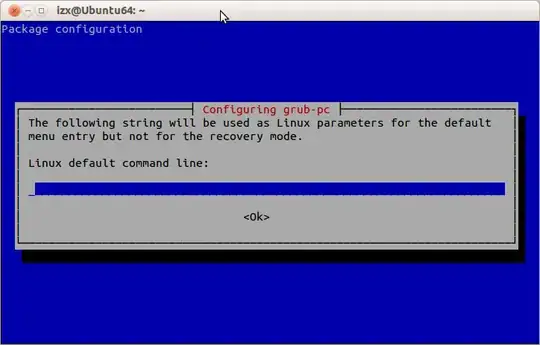

What is the officially supported way to change this debconf setting, preferably showing the user the helpful selection screen that used be given by sudo dpkg-reconfigure grub-pc
It works just fine in Precise (12.04). Here's what I got running it:
enter image description here enter image description here enter image description here enter image description here five
