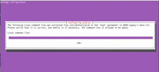

I need to reconfigure grub to use a different install device. Other threads indicate that there will be a screen that prompts me to select a device:

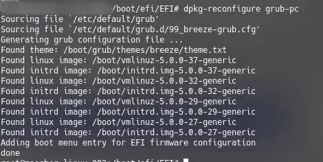

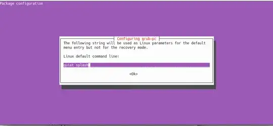

However, no such screen exists. It exits after the 2nd one.
How do I select the boot device?
Screen 1 enter image description here
Screen 2
After Screen 2
