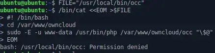

I don't know to much about linux and server creating but I wanna create my private owncloud web drive, I have linux Ubuntu 20.04 server on my Raspberry pi4 installed. I have started using this tutorial to set it up but I'm having issues at the beginning. When I'm trying to create Helper Script(?):
Create the occ Helper Script
Create a helper script to simplify running occ commands.
FILE="/usr/local/bin/occ"
/bin/cat <<EOM >$FILE
#! /bin/bash
cd /var/www/owncloud
sudo -E -u www-data /usr/bin/php /var/www/owncloud/occ "\$@"
EOM
Make the helper script executable:
chmod +x /usr/local/bin/occ
In my terminal I get this kind of error:
Terminal screenshot
How make it work?

This is crazy, the tutorial uses ubuntu, where 'root' isn't usable directly, it then assumes you have logged in as root.
Either wrap the code in another script and run that with sudo, or extract the three lines for the script from the code and create the script directly with an editor. If you do the latter, remove the '' from the last line i.e. "\$@" becomes "$@"
If you're getting a permission denied error, you can try this instead:
sudo tee "$FILE" <<'EOM'
#! /bin/bash
sudo -E -u www-data /usr/bin/php /var/www/owncloud/occ "$@"
EOM
This will run tee with sudo, which should allow writing to the /usr/local/bin/occ file. (See How to solve "permission denied" when using sudo with redirection in Bash?) Then you can use the chmod command with sudo as well.
