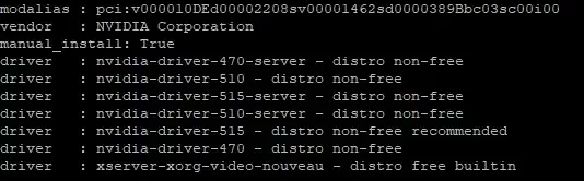

I run into the same error and I want to sum it up a little. Like @matigo mentioned, this is not a default behavior and comes with an UI. I didn't install it on purpose but when I was looking for my nvidia drivers by using ubuntu-drivers devices this was displayed:
The recommended driver was a non-server driver. With this installation I got an UI on board by mistake. The solution was like @hphex said here and as easy as firing this command:
sudo apt-get remove xserver-xorg-core
Be careful when picking the drivers, I hope this helps
