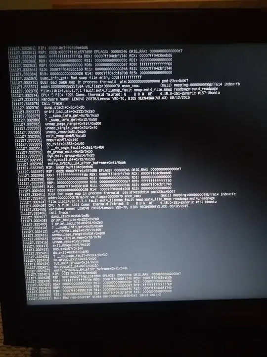

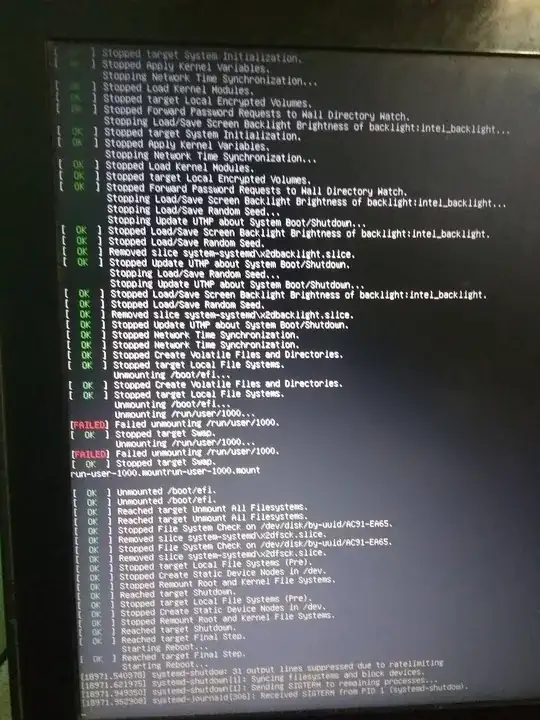

I have Ubuntu 18.04 running in a dual boot setup along with Windows 8.1 From the past 3 days, Ubuntu has become completely unusable on my laptop because it keeps freezing randomly after some time. I already had network issues with Ubuntu wherein my Wifi would randomly disconnect after some time and my Wifi connection would become invisible. I sometimes had to turn off my Wifi for 5-10 minutes and then it would reconnect and the internet would work.

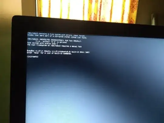

Till yesterday, I was getting some errors related to inodes on a black screen during startup. I have posted images of those messages. Also, when my laptop froze, I was ableto restart it by pressing Alt + Sys Rq + reisub, but today even this has stopped working. I have to turn it off using the power button on the laptop and then turn it back again.
Havent installed any new programs recently, just an update about 4-5 days ago.
enter image description hereenter image description here

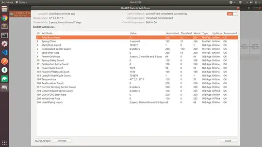

EDIT: O/P of grep -i sda /var/log/syslog*:
username@homepc:~$ grep -i sda /var/log/syslog*
Binary file /var/log/syslog matches
/var/log/syslog.1:Jul 24 00:31:04 homepc smartd[1528]: Device: /dev/sda [SAT], SMART Usage Attribute: 194 Temperature_Celsius changed from 104 to 103

This was the screen I saw when even rebooting froze (it wouldnt proceed further):

file system
At the initramfs prompt, type:
fsck -f /dev/sda13
Paging fault
BUG: unable to handle kernel paging request at ffff92d742a2bad4

It looks very familiar to Ubuntu 18.04.05 LTS Desktop hangs with since kernel 4.15.0-151 and systemd 237-3ubuntu10
Try downgrading the kernel to the previous version.
