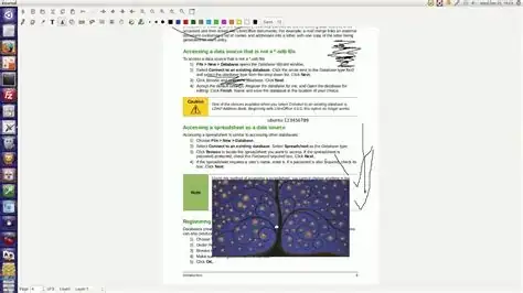

Xournal
xournal screenshot
I've used it for years to sign documents using a transparent png and fill in fields. It's a little clunky, maybe, but it works very well. I think it was intended for use on tablets with a stylus to make drawings, but it supports "PDF Annotation" as well.
