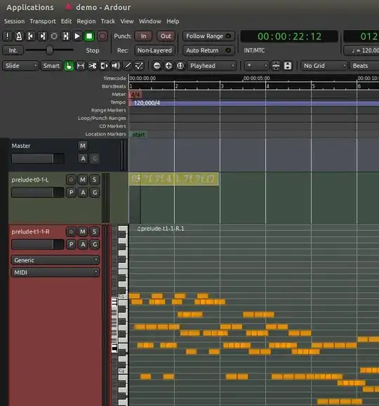

I know it's a bit too late, but for future users, Ardour seems to be the best option, there's a free and paid version and it is available in Ubuntu's repo, you can install it via
sudo apt install ardour
screenshot
