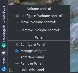

To add another panel, move mouse over an existing panel and right-click (in an unused area - this is the tricky bit; if you hover an item, the right-click will be interpreted as being for that item and not the panel itself).
You'll get a new menu offering numerous items including
  • Configure Panel
  • Manage Widgets
  • Add New Panel
  • Remove Panel
  • Lock This panel
(Volume control options also appear in the menu I've pasted, as that's where my mouse was near)
You click "Add New Panel".

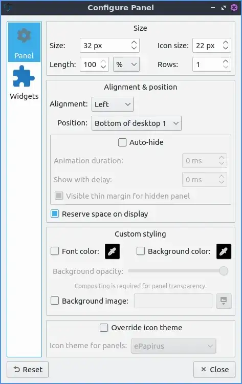

A "Configure Panel" window opens, where you can use drop-downs to select which display, position on display etc, but once you've positioned it, decided if you'll reserve space for it, set colors/background, size etc, you can move to the Widgets tab and add the items you want there.
Note: this picture is found on the manual; which is where I'll suggest you go. The only trick is the right-click is effected by whatever items you are hovering over, so try and pick an empty bit of the panel for the panel options to show; upper/lower edge can help

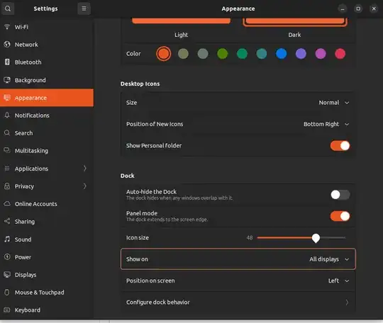

In the case of Ubuntu you can go into Appearance -> Dock and enable Show on as All displays.

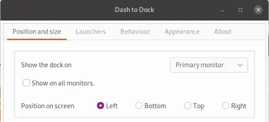

You can enable this feature using a widget called "Dash to Dock".
The steps I followed are:
  • In Gnome Tweaks, go to Extension->Dash to Dock and select enable.
  • Click the settings button.
  • In the Dash to Dock dialogue box, select Position and Size
  • At the top of this screen is the option to show the Dock on all monitors.
