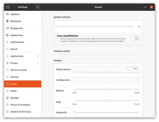

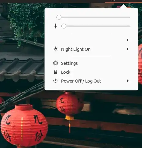

In my Ubuntu Software Updater, I ticked some random updates that were available and clicked 'install'. But midway during the downloads I cancelled the update and powered off my system. Until before I powered off my system everything was working fine, and by that I mean: my internet and sound controls in system menu. Also there were no lags.
When I reopen my system, I see the following problems:
✔ System Menu Icons and System Menu Drop Down are all messed up.
✔ Some system menu icons (including the sound icon) are not visible.
✔ The system menu volume bar doesn't seem to have any effect on the volume. Although the speakers seem to be working, because they produce sound when I play some movie or mp3.
✔ When I open the system setting, it lags very badly and becomes unresponsive every now and then upon clicking.
✔ The sound settings inside system settings are all blank.

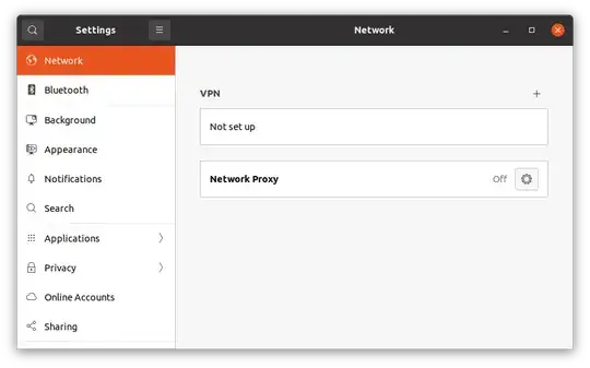

✖ Doesn't connect to internet when I insert my dongle. Also I am unable to connect via mobile tethering.

UPDATE 2
  • I did as instructed by @Raffa, and it worked!
Most of the output in your systemctl --state=not-found is usual ... I would suggest reinstalling ubuntu-desktop like so sudo apt install --reinstall ubuntu-desktop
This fixed the messed up system menu icons and drop-down and also the blank sound settings problem.

New Findings
  • Doing an lshw shows DISABLED written against my networks and link=no in each of them, whereas under normal circumstances (e.g. proper working internet on a live boot), the word DISABLED is absent and link=yes. Any ideas how we might resolve this?
$ lshw -C network
*-network:0 DISABLED <---------------------- Dongle description: Ethernet interface physical id: 1 bus info: usb@2:1.6.4 logical name: enxfcde56ff0106 serial: fc:de:56:ff:01:06 capabilities: ethernet physical configuration: broadcast=yes driver=rndis_host driverversion=22-Aug-2005 firmware=RNDIS device link=no multicast=yes
*-network:1 DISABLED <---------------------- Tethered phone description: Ethernet interface physical id: 2 bus info: usb@2:1.5 logical name: usb0 serial: ea:af:19:e2:c4:6c capabilities: ethernet physical configuration: broadcast=yes driver=rndis_host driverversion=22-Aug-2005 firmware=RNDIS device link=no multicast=yes
  • also my network settings appear as such
