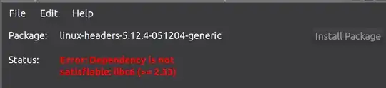

Those headers appear available here, very first link even:
**However they won't install without a libc6 2.33 **
Fiddling the hard way with libc6 versions sounds not like a good idea, or is it?
Are those “headers” available as a binary elsewhere? (my poor memories of C/C++ coding would tell me, that header files itself don't need compilation, but well in this context I have no clue what they are anyway...)
If this is the valid method to find out, I am on libc verison 2.31, so just two microversions below.
> ldd --version
>     ldd (Ubuntu GLIBC 2.31-0ubuntu9.2) 2.31
So behaps I may dare upgrade? Or is this dangerous? Or fiddle with the header package (how?) to accept 2.31? (wildly guessing there is no vital feature hidden in that minor upgrade...)
