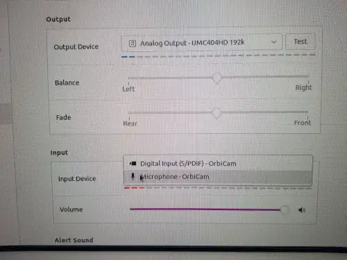

The main problem is that I can't select the interface as microphone input any more. The only available input is from my webcam, where previously it allowed me to select the UMC404HD as microphone as well:
Photo here, since you can't take screenshots of a drop-down
404 not found, as they say.

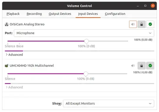

However the device is plugged-in and somehow working. Pavucontrol does show me the device and its volume levels:
Pavucontrol shows the device
These levels peak as I tap on the microphone. It's actually getting input from it. But it's somehow not allowing it to be chosen as a microphone. Note also that the "Port:" drop-down is missing from the UMC404HD device.

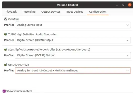

In the Configuration tab of Pavucontrol, the device is configured as output+input: Analog Surround 4.0 Output + Multichannel Input
