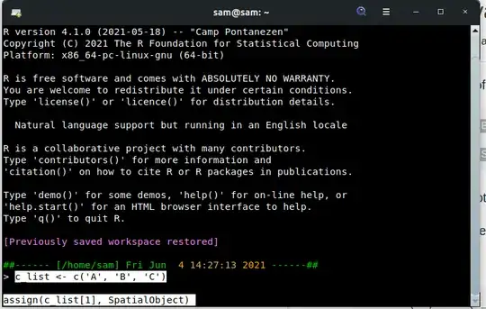

However, I used R interactively from the terminal and when I paste something into the terminal, the same issue of highlighting the text appears. Even more annoying, if I paste multiple lines in then only the first one executes and the remaining lines are left 'piled up' (the line with assign(c_list[1]....). This means I have to hit enter twice before I can enter anything into the terminal.
