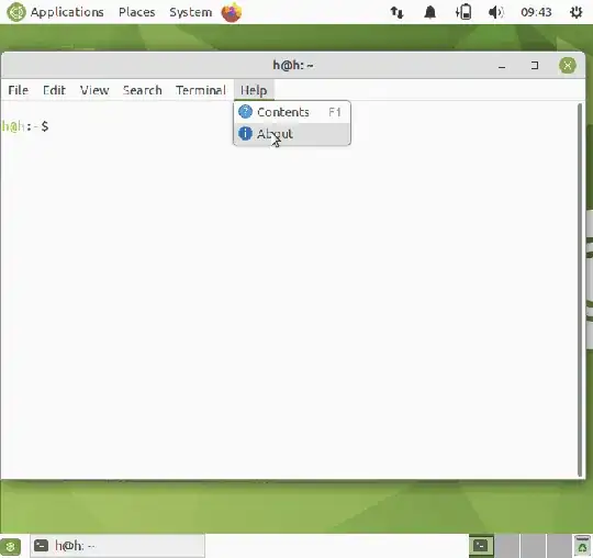

I'm seeing this bug in default MATE Terminal on fresh installation of 21.04 too,
screencast
so I have reported it to launchpad as bug 1926256 . Please mark yourself as affected by this bug and add a comment about GNOME Terminal use-case.

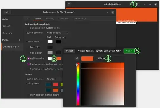

As suggested here, you can change the Gnome Terminal highlight color to something other than white, so it does not conflict with the "bracketed paste" feature of bash.
  1. Click on the header bar menu button in Gnome Terminal
    Click "Preferences"
    Under "Profile" in the left pane, select your profile (i.e. "Unnamed")
    Click the "Colors" tab
  2. Check-mark "Highlight Colors"
  3. Click the Background color box (the second box)
  4. Enter the hexadecimal value for the highlight color you want to use.
    You may want to chose one of the colors from the official Ubuntu Color Pallet:
    • Aubergine... #924D8B
    • Ubuntu Orange... #E95420
    • Light Orange... #F29879
  5. Click the Select button to apply your change.
After making this change:
  • The "bracketed paste" text will be highlighted in white, per the changes to bash.
    (See "AND THIS IS PASTED" text in the screenshot).
  • Text that you select using gnome-terminal will be your chosen color from step 4 above.
    (See "THIS IS SELECTED" text in the screenshot).
Changing Gnome Terminal Highlight Background Color
