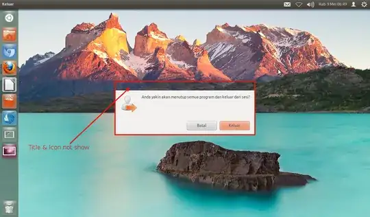

window (title and icon) sometimes doesn't appear. As a solution to this, I have to logout and login again. Is there something wrong with my system? How to make sure that this doesn't happen again?

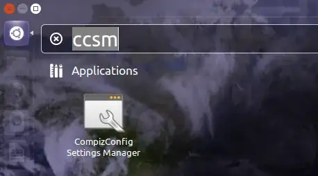

  2. CompizConfig Settings Manager
    Install CCSM (If you don't already have it) by running following command in terminal
    sudo apt-get install compizconfig-settings-manager
    Open it by searching "CCSM" in Unity dash.

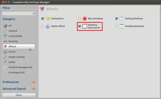

    Once open, Click on the "Effects" category and make sure that "Window Decoration" is enabled.

I just disabled Window Decoration and restarted the PC since Unity seemed not working anymore (and to be sure that everything restarts properly). Then I re-enabled Window Decoration and restarted again (for the same reason).
After that, Window Decoration works again!
