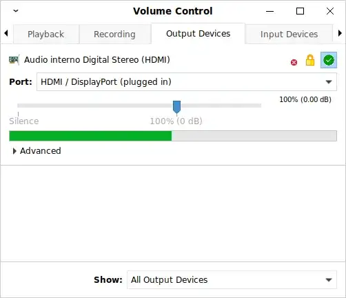

Using pavucontrol and starting a song, it says audio comes out but in reality there is no sound output.
