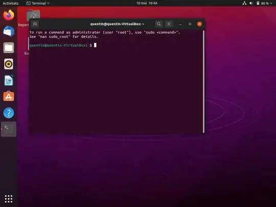

I have been searching but I cannot find where this message is kept:
Terminal window with warning in English
Here is the message as text:
To run a command as administrator (user "root"), use "sudo <command>".
See "man sudo_root" for details.
I want to translate this message into my language, so others would understand it better. It would give a better first impression.

You could edit the /etc/bash.bashrc file and manually change the sudo hint text to whatever you like. The relevant section is the following:
# sudo hint
if [ ! -e "$HOME/.sudo_as_admin_successful" ] && [ ! -e "$HOME/.hushlogin" ] ; then
    case " $(groups) " in *\ admin\ *|*\ sudo\ *)
    if [ -x /usr/bin/sudo ]; then
    cat <<-EOF
EOF
fi
esac
fi
