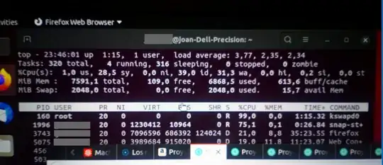

Just browsing with firefox (opening a million tabs), the computer ends up freezing, I can move the cursor but nothing else. I rebooted the computer and left a terminal with top monitoring in the corner. When it happened again, kswapd0 was using 99% of CPU. I took a picture of the frozen screen:

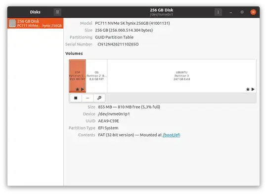

Screenshot of Disks

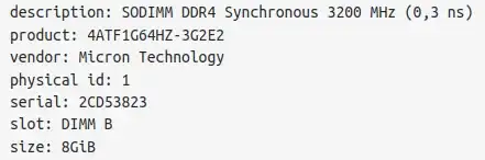

Output of lshw -C memory
joanruiz@joan-Dell-Precision:~$ sudo lshw -C memory
[sudo] password for joanruiz:
  *-firmware
       description: BIOS
       vendor: Dell Inc.
       physical id: 0
       version: 1.4.3
       date: 12/23/2020
       capacity: 32MiB
       capabilities: pci pnp upgrade shadowing cdboot bootselect edd int13floppynec int13floppy1200 int13floppy720 int13floppy2880 int5printscreen int9keyboard int14serial int17printer acpi usb smartbattery biosbootspecification netboot uefi
  *-memory
       description: System Memory
       physical id: 1c
       slot: System board or motherboard
     *-bank:0
          description: DIMM [empty]
          physical id: 0
          slot: DIMM A
     *-bank:1
          description: SODIMM DDR4 Synchronous 3200 MHz (0,3 ns)
          product: 4ATF1G64HZ-3G2E2
          vendor: Micron Technology
          physical id: 1
          serial: 2CD53823
          slot: DIMM B
          width: 64 bits
          clock: 3200MHz (0.3ns)
