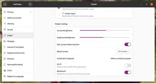

Generally you can set the keyboard brightness in the Power Settings:
Settings - Power - Keyboard Brightness
