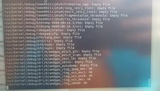

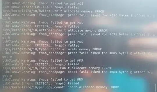

When I run ClamAV on all files, I can see allocation memory errors when the second monitor is connected:a photo, because I cannot do a printscreen
Without the second monitor, the clamav reaches some point with scanning files (after allocation errors) then the computer freezes.

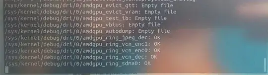

This is the output when I scan /sys/kernel/debug/dri/0: another photo, because it freezes
