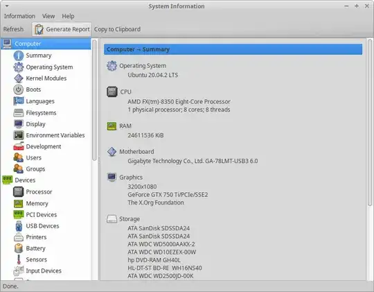

One you can try is hardinfo.
sudo apt install hardinfo
Then it can be found in Xue Menu -> System -> System Profiler and Benchmark
