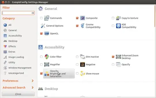

Open the CompizConfig-Settings-Manager by typing ccsm in the dash. In the CCSM's window, under the Accessibility section, enable the Opacity, Brightness and Satuaration by placing a tick mark on the corresponding checkbox.
CCSM
