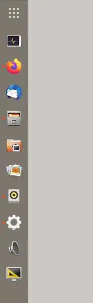

This I know is the dock:
Screenshot of the Dock

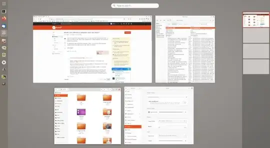

Activities Overview screenshot:
Screenshot of the Activities Overview screen

In the original unmodified gnome-shell (without the Ubuntu distro's customizations), the part we in Ubuntu know as Dock,
  • is only a "subcomponent" of the Activities Overview (and Apps Grid) screen, available only together with it, while you are in the activities overview mode. If you leave the Activities Overview, this subcomponent disappears too, and can't be accessed otherwise.
    • as you can observe in the above screenshot of the Activities Overview, the vertical bar with the app launcher icons on the left side is present
  • in original gnome-shell terminology however, this subcomponent is called — wait for it — Dash.
The gnome shell extension Dash to dock (shipped with and enabled in Ubuntu by default) "extracts" this subcomponent (at that point, still called Dash) out of the Activities Overview, sticks it to the edge of your desktop permanently, and invites you to refer to it as Dock from then on.
