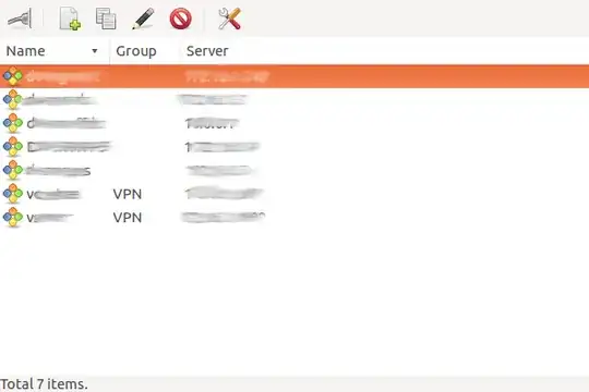

When you start remmina you get this window enter image description here
(but without any entries), click on the green "plus" to get the following window
Here you must enter the remote machine's IP-address (or name), your username/password on the remote machine (if you leave the password out you are prompted for it during the actual connection) and the domain/workgroup to use.
The other tabs can stay as they are (for the moment at least). Now first click save, then connect, the remote machine will "appear".
