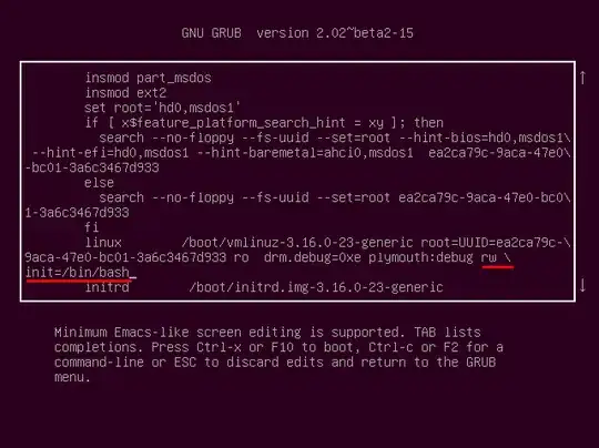

58
Occasionally, you might not be able to use the single method as described in the accepted answer. In those cases you can tell the Linux kernel to use a different init like so:
init=/bin/bash
For example
          ss
slm

slm's solution worked for me in Ubuntu 20.04 when I had changed the ownership of the entire /etc directory.
I followed the instructions here (in the Alternate Root Shell Method section) and by the grace of Jesus I could boot in SINGLE USER MODE. Then I could get into the root shell without the root password (which Ubuntu doesn't give you).
This is done (roughly) as follows:
  1. reboot
  2. enter the GRUB console by pressing shift (left, right, or both?) during the boot splash
  3. select the regular kernel image you always boot from (this wasn't in the top-level menu, but in a menu 1 level deep)
  4. press e
  5. go to the line that starts with linux and move the cursor to the end
  6. remove the part that says ro quiet splash (or something like that) and add this at the end of the line: rw init=/bin/bash
  7. press Ctrl-x to boot into that image with these boot parameters
That's roughly what allowed me to get into a root shell without the root password.
