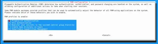

  1. CTRL+ALT+F2 on the login screen - terminal will open.
  2. Login 3.sudo pam-auth-update
  3. Deselect "Fingerprint authentication"
  4. Reboot
  5. Login through UI
