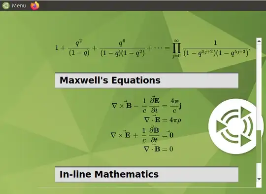

FYI - original script runs normally on Ubuntu MATE 14.04 LTS (EoL), 16.04 LTS (EoL) and 18.04 LTS.
For Ubuntu MATE 20.04 LTS you can use the following adapted code:

Notes:
  1. I'm not Python expert yet, but it works as expected:
    HTML on Ubuntu MATE desktop
  2. The script needs the packages installed by sudo apt-get install python2 python-gi gir1.2-webkit2-4.0 .
