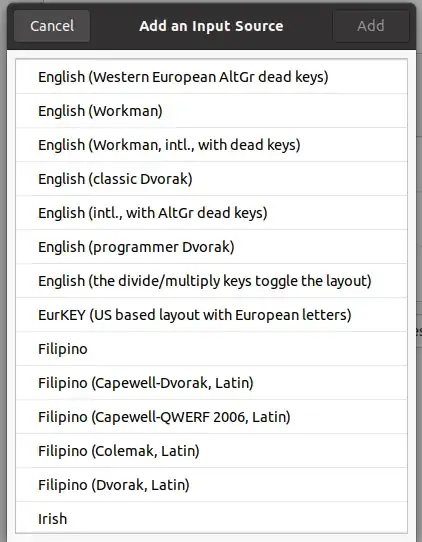

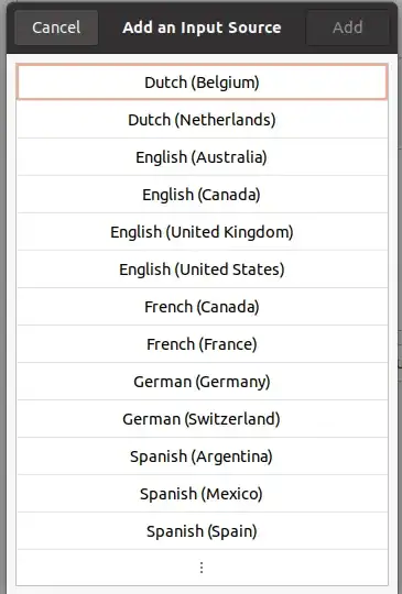

Now, the user will be able to run gnome-control-center (aka 'Settings'), go to 'Region and Language' and add a keyboard layout:
Language selection in gnome-control-center
Choose English (United States) and see this after you scroll down quite a bit:
Choose EurKEY and that user is done, even when the system is shutdown and rebooted. In other words: the setxkbmap eu is no longer necessary!
