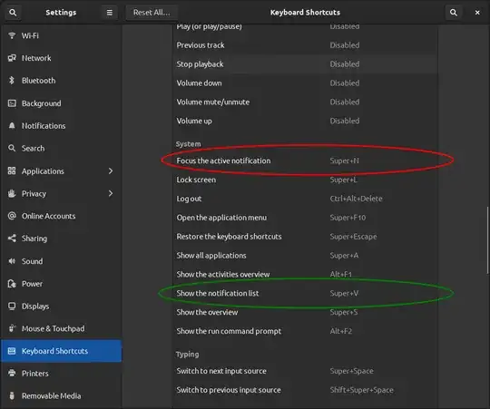

It's a bit unclear if you want a keyboard shortcut to access the notification list or the currently active shortcut. Whichever the case, you don't need to add custom keyboard shortcuts for these tasks, as predefined ones already exist:
  • If you want to open the notification list, just press Super+V. You can move between items in this list using the arrow keys. You can also open a notification by selecting it and pressing Enter or you can remove a notification by selecting it and pressing Delete.
  • If you want to focus the currently active notification, just press Super+N.
If you would like to use other shortcuts for these tasks, open Settings → Keyboard shortcuts, search for the Show the notification list (green ellipse in the screenshot below) or Focus the active notification (red ellipse in the screenshot below) shortcut, respectively, and change them to whichever shortcuts you like.
Keyboard shortcuts
