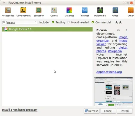

So I would recommend to use PlayOnLinux with Wine to install the Picasa application. You have to:
  1. Install PlayOnLinux
    sudo apt-get install playonlinux
  2. Launch PlayOnLinux
  3. Click Install
  4. Search for Google Picasa in the wizard, click Install
    Picasa in PlayOnLinux
  5. Allow wizard to download Picasa 3.9 from the internet and install it
