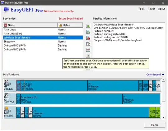

You haven't said which version of Windows or whether you're on UEFI.
If you're using a proper UEFI boot (and not legacy boot), it is possible to temporarily boot to the Windows UEFI boot entry. On Linux, this can be done using tools like efibootmgr. On Windows, I personally use EasyUEFI. It is free for personal, GUI use, but not for enterprise or CLI use. I can't vouch for its safety. It also seems to be somewhat slow, but it does seem to work
In my own setup, which uses Arch Linux (kernel EFI shim, without GRUB), and Windows 10, this is how it looks like, after picking "Manage EFI Boot Option" on the starting screen:
Image showing one-time boot option
If you're using UEFI boot, you should see something similar for Windows, plus a single entry for Ubuntu (which loads GRUB), plus some other device-specific options. The one-time boot option can then be used to set to boot to the UEFI boot entry for Windows once, and then back to GRUB the boot after that. After setting that, you restart as normal.
