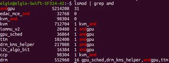

I'm running Ubuntu 20.04 on my Acer swift 3 laptop for a few months. In overall, system is performing well, but sometimes my laptop becomes totally unresponsive. In such cases, my only solution is shutdown (pressing and holding power button for a few seconds) and restart the computer. I simply can't understand and debug this problem. Screenshot of important system logs (logged before one of crashes) from GNOME logs app is attached here:
I want to mention that system freeze happens when watching media files in browsers, such as video on facebook, youtube. It always happened both on firefox and chromium browsers. I can provide you with additional related system info/logs. Please help me to identify the issue.

lsmod | grep amd

Remove nomodeset from your /etc/default/grub and then sudo update-grub.
You have an older version of the AMD video driver. Download and install version 20.20 at https://www.amd.com/en/support/kb/release-notes/rn-amdgpu-unified-linux-20-20 or https://drivers.amd.com/drivers/linux/amdgpu-pro-20.20-1098277-ubuntu-20.04.tar.xz.
Installation instructions are at https://amdgpu-install.readthedocs.io/en/latest/.
Reboot your computer.
