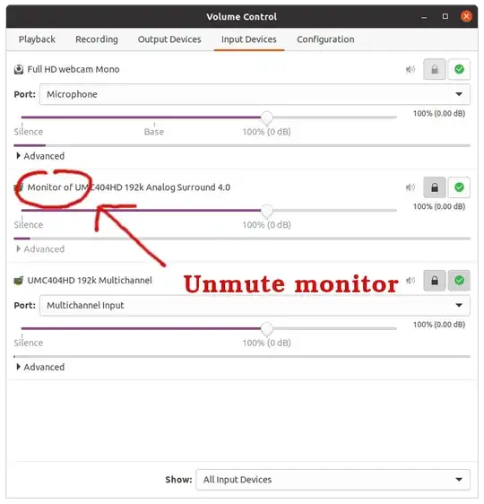

I found the issue. The monitor on my soundcard was muted in Pulseaudio Volume Control, also known as pavucontrol
Simply install Pulseaudio Volume Control from the Software app, or use sudo apt install pavucontrol
Then run it, go to the Input Devices tab, and then check if the monitor of your sound card is unmuted.
I don't know why it was unmuted, but after trying about a hundred things, I tried checking my pulseaudio settings and this fixed it.

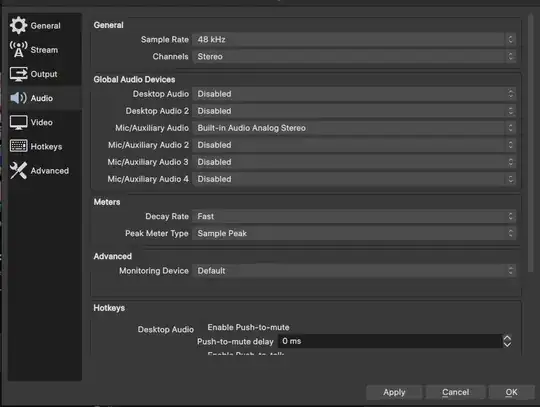

  1. Go to your OBS settings
  2. Go to audio setting
  3. In (Global Audio Devices) check if Desktop Audio is set to disabled
  4. If it is disabled click the audio channel you want for audio output
  5. Tada! You will find the audio output working in your obs now
