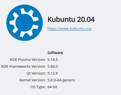

I was using Ubuntu 20.04 and then I install and switched to KDE Plasma desktop. Now I'm using KDE 5.18.5 and I want to upgrade to the latest version (5.21), but there's no update on apt.
My question is: How can I upgrade KDE Plasma to 5.21?

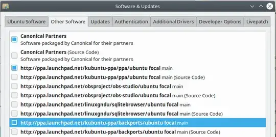

Also I've added kubuntu ppa and its backport but no update after running sudo apt update and sudo apt upgrade
~  sudo apt-get upgrade
Reading package lists... Done
Building dependency tree
Calculating upgrade... Done
0 upgraded, 0 newly installed, 0 to remove and 0 not upgraded.
beigirad
  • 333
Upgrade from this PPA: https://launchpad.net/~savoury1/+archive/ubuntu/kde-5-80 - Backport of KDE 5.80 stack (and dependencies) for Xenial, Bionic & Focal.
